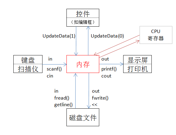

通常,输入输出的方向性问题是站在内存的角度去看的:

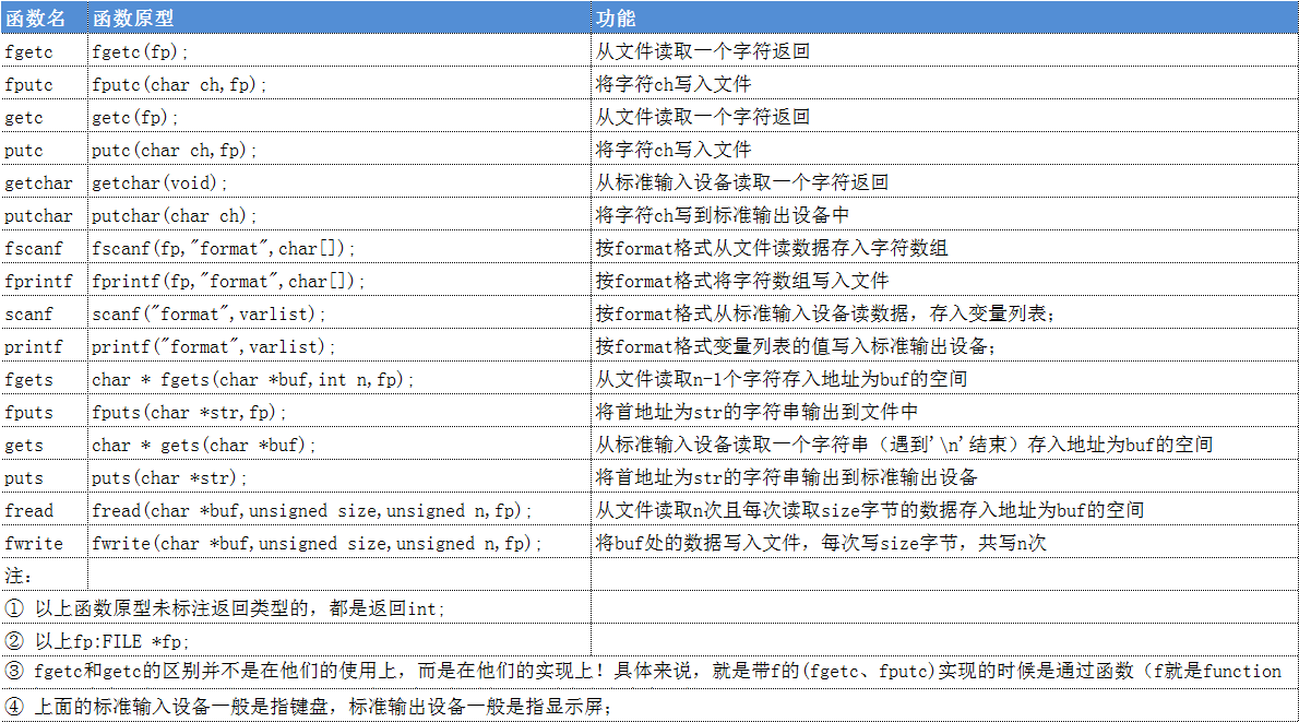

#include<iostream>#include<fstream>using namespace std;int main(){ fstream file("test.txt",ios:ut); if(!file.fail()) { cout<<"star write"<<endl; file<<"1 name:"<<"\r\n"; file<<"2 sex:"<<endl; cout<<"successfully writed!"<<endl; } else cout<<"can not open"<<endl; file.close(); system("pause"); return 0;}// reading a text file#include<iostream.h>#include<fstream.h>#include<stdlib.h>int main () { char buffer[256]; ifstream in("test.txt"); if (! in.is_open()) { cout << "Error opening file";  exit (1);  } while (!in.eof() ) { in.getline (buffer,100); cout << buffer << endl; } system("pause"); return 0;}三、有关输入输出的常用函数putc(); 字符fscanf(); 字词,遇到空格和换行时结束puts(); 串、行fputs(); 串、行,比puts()安全,是puts()的替代函数printf()与puts(),前者不只是字符串,scanf()与gets()也是一样;
