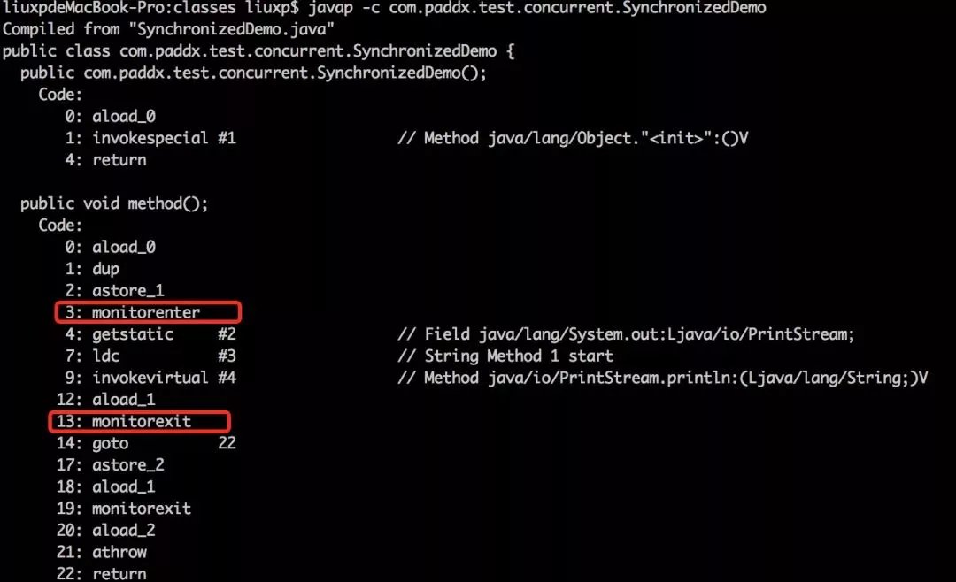

再回头上面的问题就一目了然了。我们先通过反编译下面的代码来看看 Synchronized 是如何实现对代码块进行同步的:

反编译结果:
关于这两条指令的作用,我们直接参考 JVM 规范中描述:
monitorenter :Each object is associated with a monitor. A monitor is locked if and only if it has an owner. The thread that executes monitorenter attempts to gain ownership of the monitor associated with objectref, as follows:
• If the entry count of the monitor associated with objectref is zero, the thread enters the monitor and sets its entry count to one. The thread is then the owner of the monitor.
• If the thread already owns the monitor associated with objectref, it reenters the monitor, incrementing its entry count.
• If another thread already owns the monitor associated with objectref, the thread blocks until the monitor's entry count is zero, then tries again to gain ownership.
这段话的大概意思为:每个对象有一个监视器锁(Monitor),当 Monitor 被占用时就会处于锁定状态。
线程执行 Monitorenter 指令时尝试获取 Monitor 的所有权,过程如下:
如果 Monitor 的进入数为 0,则该线程进入 Monitor,然后将进入数设置为 1,该线程即为 Monitor 的所有者。
如果线程已经占有该 Monitor,只是重新进入,则进入 Monitor 的进入数加 1。
如果其他线程已经占用了 Monitor,则该线程进入阻塞状态,直到 Monitor 的进入数为 0,再重新尝试获取 Monitor 的所有权。
monitorexit:The thread that executes monitorexit must be the owner of the monitor associated with the instance referenced by objectref.
The thread decrements the entry count of the monitor associated with objectref. If as a result the value of the entry count is zero, the thread exits the monitor and is no longer its owner.
Other threads that are blocking to enter the monitor are allowed to attempt to do so.
这段话的大概意思为:执行 Monitorexit 的线程必须是 Objectref 所对应的 Monitor 的所有者。
指令执行时,Monitor 的进入数减 1,如果减 1 后进入数为 0,那线程退出 Monitor,不再是这个 Monitor 的所有者。
其他被这个 Monitor 阻塞的线程可以尝试去获取这个 Monitor 的所有权。
通过这两段描述,我们应该能很清楚的看出 Synchronized 的实现原理。

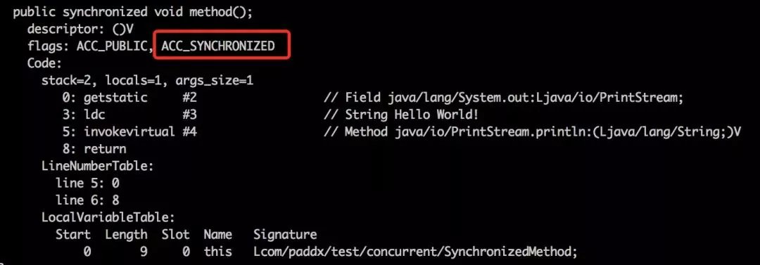

我们再来看一下同步方法的反编译结果,源代码如下:
package com.paddx.test.concurrent;
public class SynchronizedMethod {
  public synchronized void method() {
    System.out.println("Hello World!");
反编译结果:
从反编译的结果来看,方法的同步并没有通过指令 Monitorenter 和 Monitorexit 来完成(理论上其实也可以通过这两条指令来实现)。不过相对于普通方法,其常量池中多了 ACC_SYNCHRONIZED 标示符。
JVM 就是根据该标示符来实现方法的同步的:当方法调用时,调用指令将会检查方法的 ACC_SYNCHRONIZED 访问标志是否被设置。
如果设置了,执行线程将先获取 Monitor,获取成功之后才能执行方法体,方法执行完后再释放 Monitor。在方法执行期间,其他任何线程都无法再获得同一个 Monitor 对象。
其实本质上没有区别,只是方法的同步是一种隐式的方式来实现,无需通过字节码来完成。
