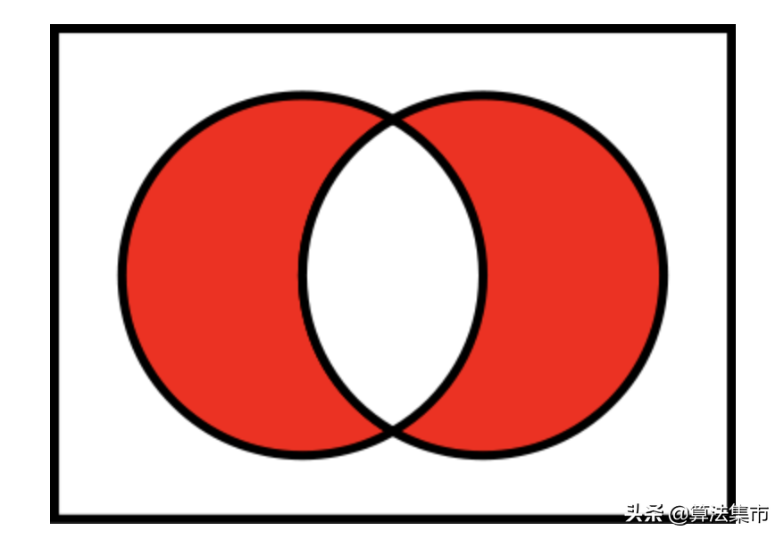

异或运算:按位异或运算,相同为0,不同为1。即:
0 ^ 0 = 0
0 ^ 1 = 1
1 ^ 0 = 1
1 ^ 1 = 0
